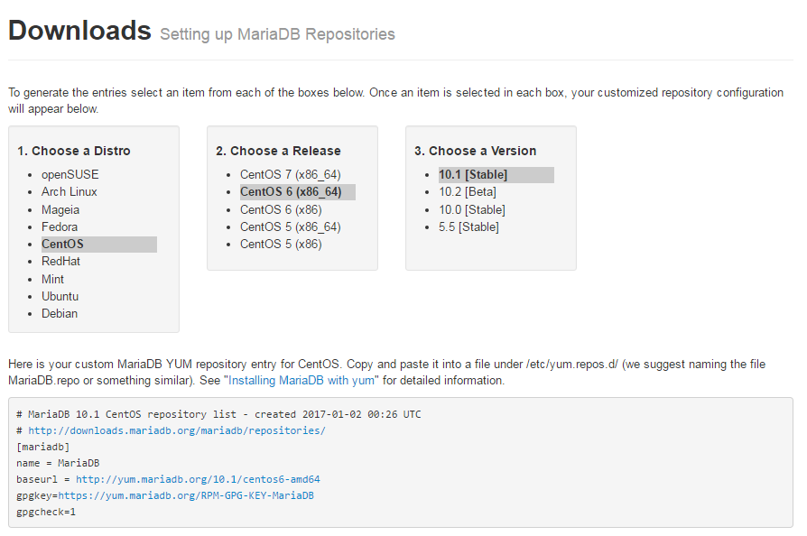

cd /etc/yum.repos.d/
vi mariadb.repo
# MariaDB 10.1 CentOS repository list - created 2017-01-02 00:27 UTC # http://downloads.mariadb.org/mariadb/repositories/ [mariadb] name = MariaDB baseurl = http://yum.mariadb.org/10.1/centos6-amd64 gpgkey=https://yum.mariadb.org/RPM-GPG-KEY-MariaDB gpgcheck=1

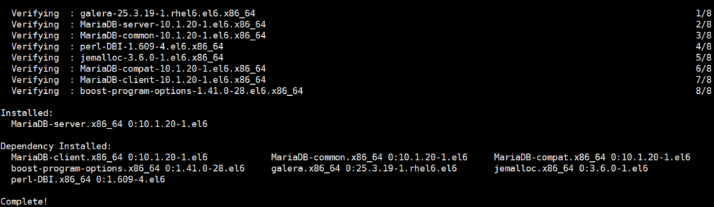

4.安裝 MariaDB Server
yum install MariaDB-server MairaDB-client MariaDB-devel*
