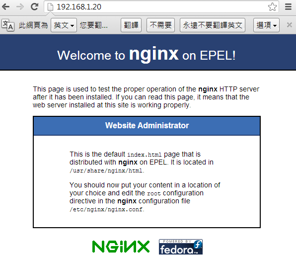

  • 啟動及驗證 port
[[email protected] ~]# /etc/init.d/nginx restart
停止 nginx: [失败]
正在启动 nginx: [确定]
[[email protected] ~]# /etc/init.d/php-fpm restart
停止 php-fpm: [失败]
正在启动 php-fpm: [确定]
[[email protected] ~]# netstat -tlnup | grep nginx
tcp 0 0 0.0.0.0:80 0.0.0.0:* LISTEN 5174/nginx
[[email protected] ~]# netstat -tlnup | grep php-fpm
tcp 0 0 127.0.0.1:9000 0.0.0.0:* LISTEN 5189/php-fpm
  • 測試:http://localhost
nginx
設定開機啟動nginx及php-fpm
chkconfig nginx on
chkconfig --level 234 nginx on
chkconfig php-fpm on
chkconfig --level 234 php-fpm on

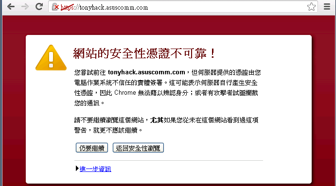

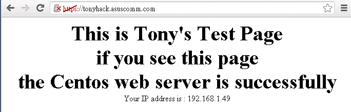

NGINX 的 SSL
  • 設定檔
[[email protected] conf.d]# cat /etc/nginx/conf.d/tonyhack.asuscomm.com.conf
# the tonyhack.asuscomm.com
server {
#listen 80;
server_name tonyhack.asuscomm.com;
listen 443;
ssl on;
ssl_certificate /etc/nginx/certs/server.crt;
ssl_certificate_key /etc/nginx/certs/server.key;
root /var/www/html;
index index.html index.htm index.php;
location ~ \.php$ {
fastcgi_pass 127.0.0.1:9000;
fastcgi_index index.php;
fastcgi_param SCRIPT_FILENAME $document_root$fastcgi_script_name;
include fastcgi_params;
  • 產生憑證 in /etc/nginx/certs 目錄內  請自已加目錄certs
[[email protected] certs]# openssl genrsa -des3 -out server.key 1024
Generating RSA private key, 1024 bit long modulus
e is 65537 (0x10001)
Enter pass phrase for server.key:
Verifying - Enter pass phrase for server.key:
[[email protected] certs]# openssl req -new -key server.key -out server.csr
You are about to be asked to enter information that will be incorporated
into your certificate request.
What you are about to enter is what is called a Distinguished Name or a DN.
There are quite a few fields but you can leave some blank
For some fields there will be a default value,
If you enter '.', the field will be left blank.
Country Name (2 letter code) [XX]:TW
State or Province Name (full name) []:stnet253
Locality Name (eg, city) [Default City]:taiwan
Organization Name (eg, company) [Default Company Ltd]:asuscomm
Organizational Unit Name (eg, section) []:com
Common Name (eg, your name or your server's hostname) []:tony
Email Address []:[email protected]
Please enter the following 'extra' attributes
to be sent with your certificate request
A challenge password []:
An optional company name []:
[[email protected] certs]# cp server.key server.key.org
[[email protected] certs]# openssl rsa -in server.key.org -out server.key
Enter pass phrase for server.key.org:
writing RSA key
[[email protected] certs]# openssl x509 -req -days 365 -in server.csr -signkey server.key -out server.crt
Signature ok
subject=/C=TW/ST=stnet253/L=taiwan/O=asuscomm/OU=com/CN=tony/[email protected]
Getting Private key
[[email protected] certs]# ls -ashl
总用量 24K
4.0K drwxr-xr-x. 2 root root 4.0K 6月 23 21:53 .
4.0K drwxr-xr-x. 4 root root 4.0K 6月 23 21:52 ..
4.0K -rw-r--r--. 1 root root 749 6月 23 21:53 server.crt
4.0K -rw-r--r--. 1 root root 631 6月 23 21:53 server.csr
4.0K -rw-r--r--. 1 root root 887 6月 23 21:53 server.key
4.0K -rw-r--r--. 1 root root 963 6月 23 21:53 server.key.org
  • 重新啟動及測試
[[email protected] certs]# /etc/init.d/nginx restart
停止 nginx: [确定]
正在启动 nginx: [确定]
[[email protected] certs]# netstat -tlnup | grep nginx
tcp 0 0 0.0.0.0:80 0.0.0.0:* LISTEN 5771/nginx
tcp 0 0 0.0.0.0:443 0.0.0.0:* LISTEN 5771/nginx
